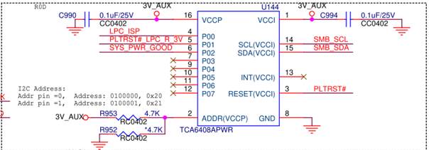

  • Bobby,
    Customer left P03-P07 open or floating.
    They will read all of pin status back in production line.
    For floating pin, they could read high or low status in different board always. They expect to read "Low" status.
    The question is that the board they could read high status. after they change a new IC, the status could become low.
    our question is why change IC could change the status at the same test environments and PCB board?
    BR,
    Jason
  • Hey Jason,
    The only thing two things I could think are is:
    1) Noise (electrical)  in the environment could have an affect.
    2) leakage current into the floating nodes may be different between ICs
    We suggest customers reference all input pins. If you have the pins floating you can reference them by setting the unused pins to outputs.
    -Bobby
