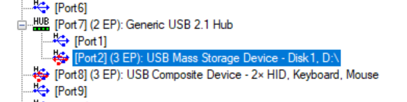

  • Both DP and DM only show as GND level voltage, I don't see any transitions. USBTreeView is below. It appears the same regardless if the USB cable is connected or not.

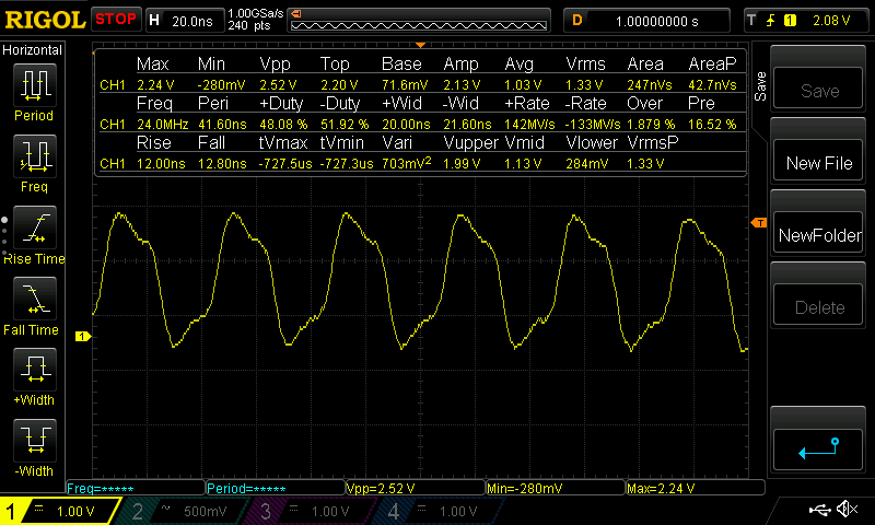

    The thermal pad is connected to a 3.62mm x 3.62mm pad which is per the datasheet land pattern. The pad is connected with 5 vias to the GND plane which runs the length of the board. I don't believe that the crystal is starting and stopping. Crystal output XO was measured using a 50MHz 1GSa/s scope with a 10x scope probe set to DC coupling. See below for the scope plot.

    This is very strange, I would not expect the crystal to keep running if the hub was not connected unless it was in test mode or SMBUS mode.  You have confirmed the state of these pins, correct?  What is the voltage on USB_R1 pin?

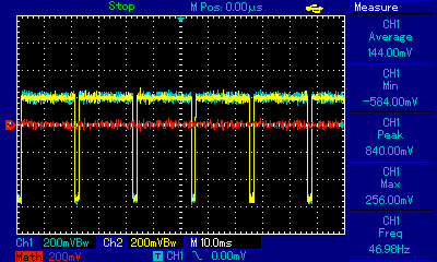

    The 3.0 Tx differential pair shows the following. There is nothing seen at all on the Rx differential pair.

  • Hi Justin,

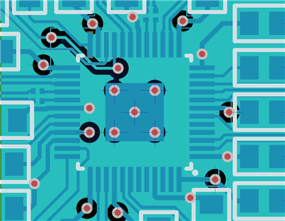

    It appears that the host does not detect the USB 3.0 portion of the TUSB8020B.  Can you confirm if the host has the expected AC caps?  Can you try a very short cable?  What does hte via pattern under the hub look like?

    Are you referring to the 0.1uF capacitors on the TXM/TXP lines? If so then I can confirm that they are present. I tried the shortest cable that we had available and the result was still the same, only USB 2.0. See below for the via pattern under the hub.

    I just tested and that particular port was not connecting other devices at 3.0. When I switched to a different port that could connect a USB 3.0 flash drive, the hub enumerated both the 2.0 and SuperSpeed hubs in USBTreeView correctly. Plugging the USB 3.0 flash drive into the hub downstream port also enumerated the device correctly under the SuperSpeed hub. The root cause was therefore just the power supply noise on the board that I noted in an earlier post.
