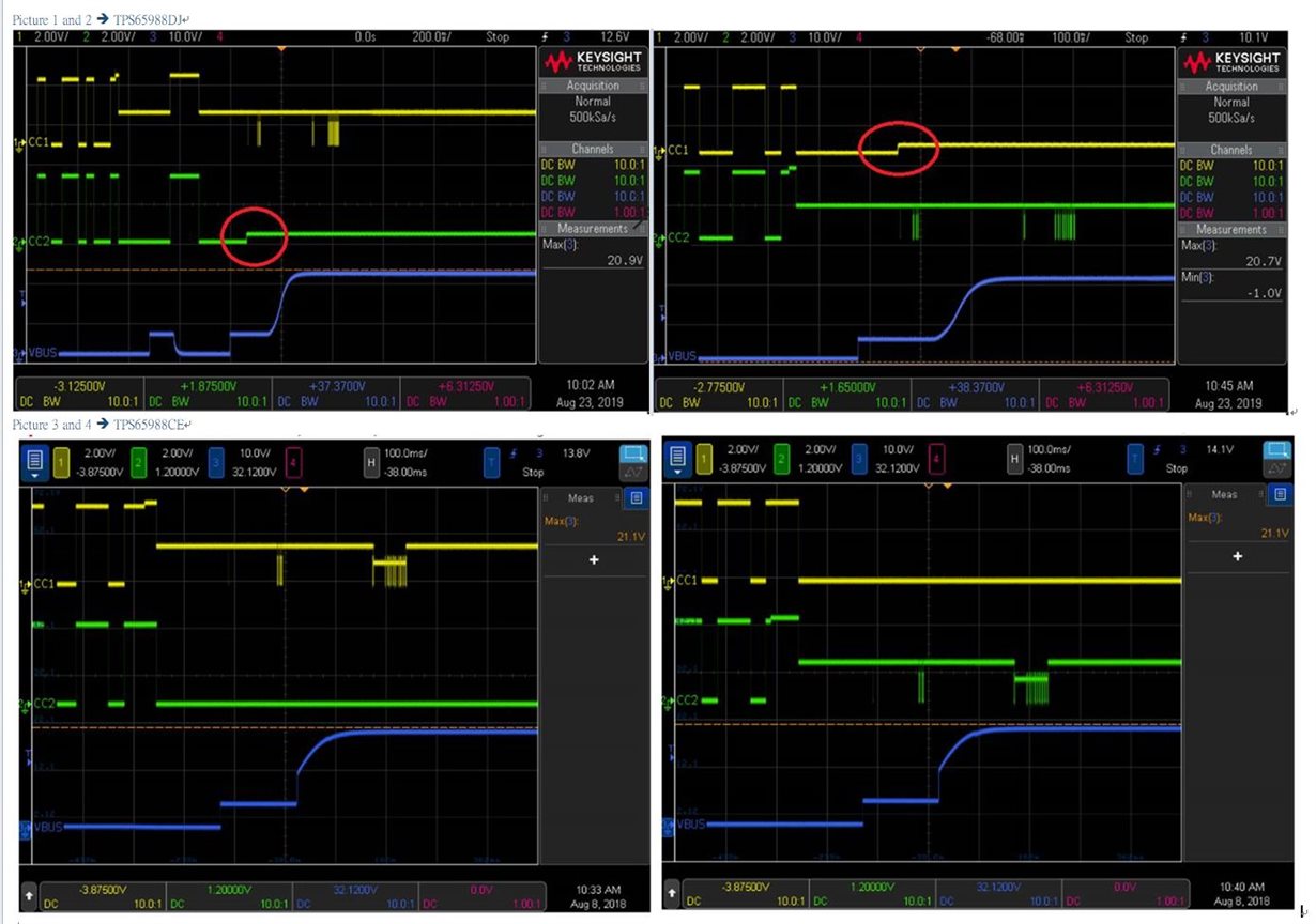

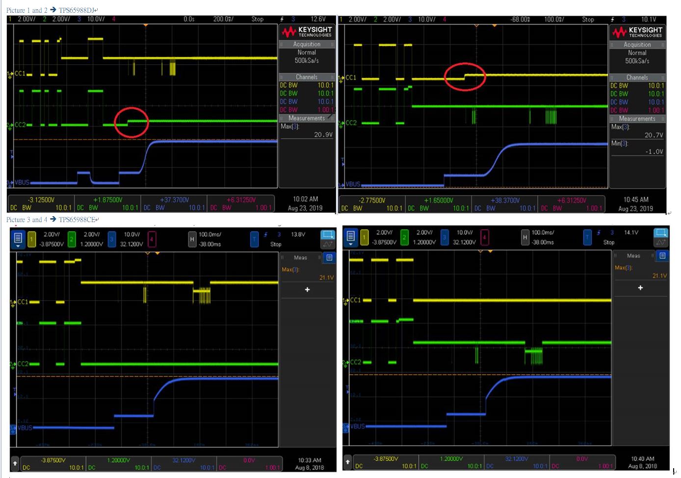

We have sue TPS65988CE in old project and new project use TPS65988DJ. 988DJ and 988CE are working.
but we have find some qusstion on CC Waveform.
I have find cc pin have 0.2V on 988DJ , but 988CE did not have 0.2V on CC.

Hi Kerr,
I do not see any concern with having 0.2V on the unused CC line. This should not cause any side effects in the system.
