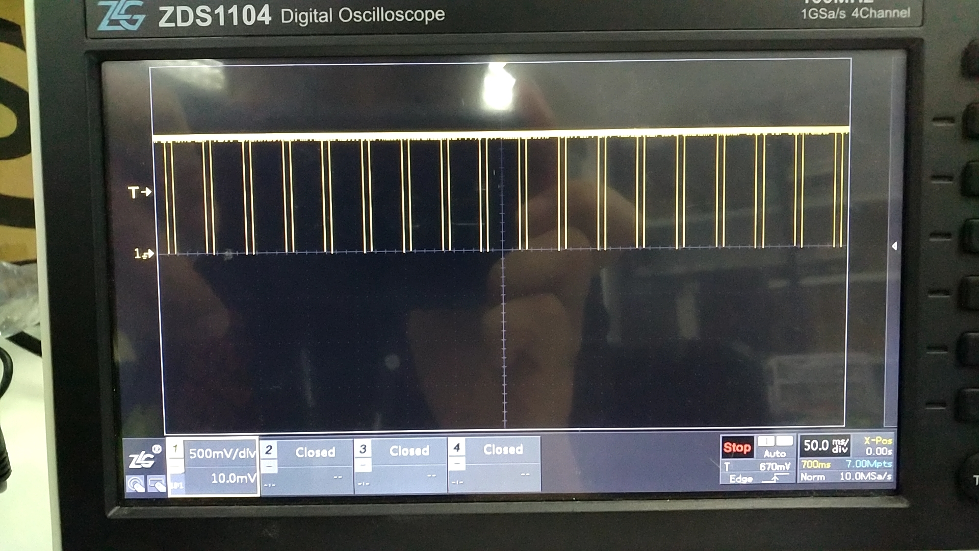

 I am working on 960+913*4 fpdlink iii cameras. I can use Nvidia Xavier capture frames with 960 + one 913 camera. But when i try 2 913 cameras +960, i can not capture, and mipi wave looks failed.
Here is my config code

Here are 960's registers
Here is 960 mipi wave
