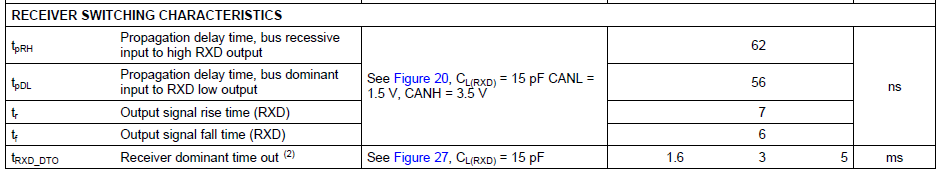

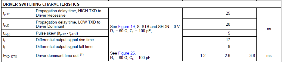

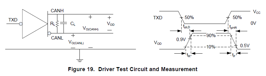

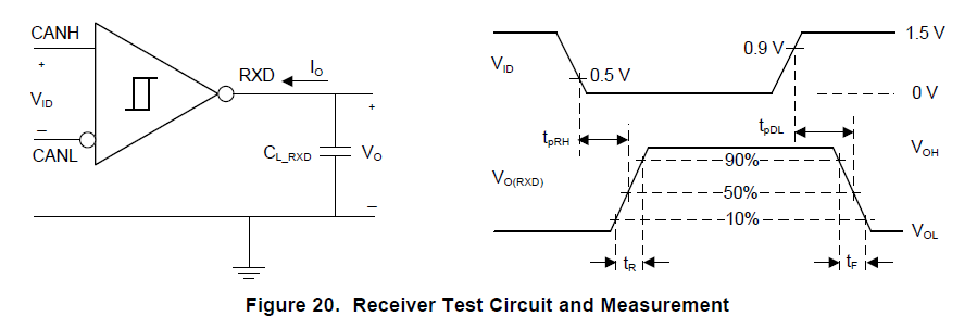

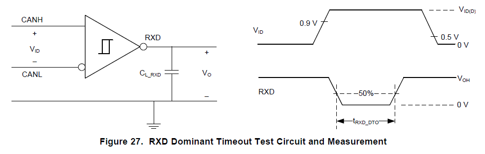

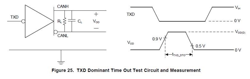

Regarding the CAN BUS measurement, if the following SPEC is used for measurement, is it necessary to increase the load of RL and CL to measure?
Drive side needs to increase RL 60 ohms CL 100pf?
Receiver needs to increase CL 15pf?
  • Hi Shu-Cheng,
    The diagrams you show are the test circuits for different specifications. If you wanted to measure those specification values under the same conditions, then you could apply those circuits. Is that what you are asking? Please let me know if I've misunderstood.
