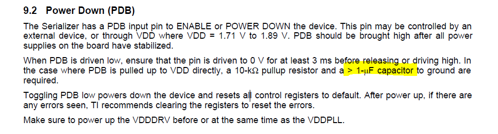

We connect the PDB pin directly to VDD.
The data sheet explains the following.
I understand that the pull-up resistance and capacitance are determined by the 3ms delay from the rise of VDD.
Can I use 1 uF or less than 1 uF, if it satisfy the delay requirement?
