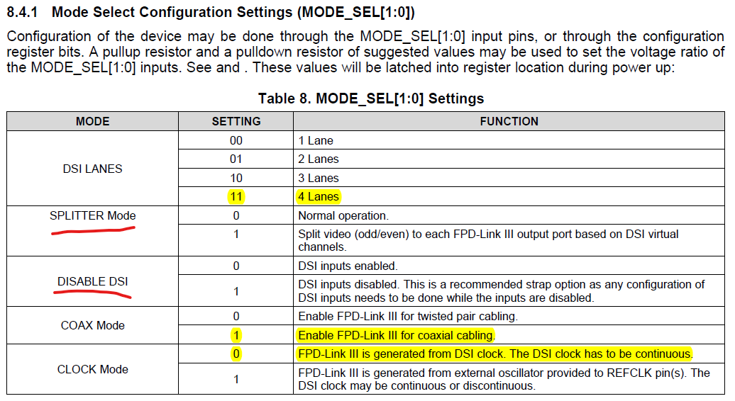

Part Number: DS90UH941AS-Q1
1.Can DS90UH941AS archieve max 1080P pixels in 1:2 mode(1*DSI Input and 2*Different FPDLINK III video output)?
2.What is the Normal operation of the splitter mode ?

1. The max pixel clock for dual-link mode is 210 Mhz with each FPD-Link III TX port running at one-half the frequency. You will need to make sure in dual/replicate mode that each output does not exceed 105 MHz pclk.
2. What do you mean by normal operation?
Sally

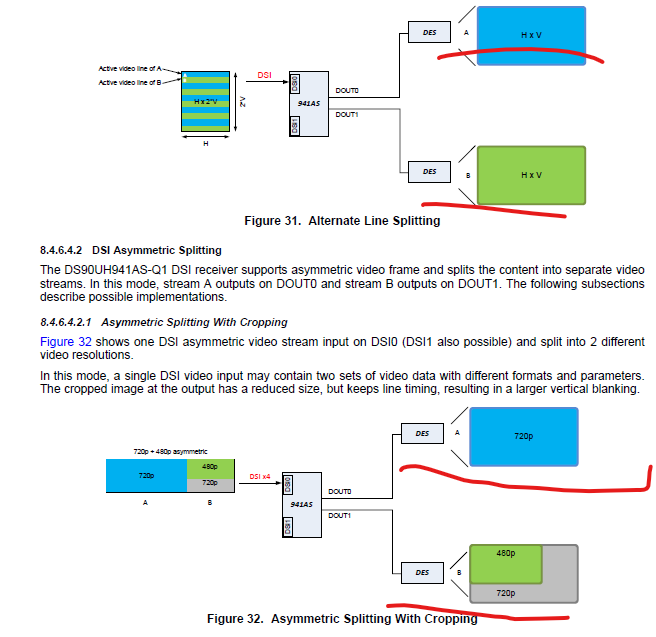

Thank you Sally!
The 2nd question is ok,but 1st question is still unclear.
If FPDLINK III TX port running at 105MHz pclk,can each Video output archieve 1080p/30fps?
We expect 1*DSI to 2*video,one is 1080p?Would you please see if there have any good advice,Thx!
