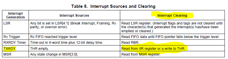

  • Hey Y.Ottey,
    The device is designed to clear the INT and that bit when you read IIR.
    This is stated in the datasheet here:
    When you did step 3 it looks like you cleared the INT and the INT does not get generated again until the THR is filled.
