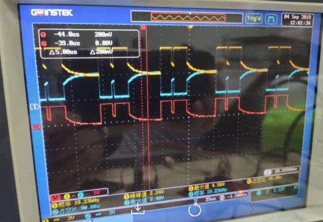

Hi team,
After configuring TCAN4550,the output waveform is as follow:
The question is why has that happened. Do you have any suggestion? The code is as follows:

  • Hi Amy,
    Can you please let us know what is connected on the CAN lines (CANH and CANL)?  You should typically have two 120-Ohm resistances, one on each side of the cable, placed between CANH and CANL.  From the waveforms it looks like this might not be present.  You would also generally need another CAN device to communicate with.  Otherwise, at the end of a frame the TCAN4550 will not receive an "acknowledgement" and may consider the frame transmission in error.
    Max
