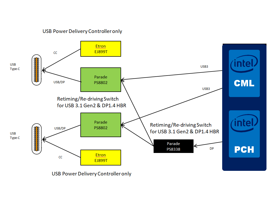

Could you please share your comments what is the preferred role for our HD3SS215 that we can suggest customer to put into their system.
Please refer to the block diagram:

Do they need a dual mode 1:2 switch? Both PS8338 and HD3SS215 support dual mode, but only support up to DP1.2.
If they only need DP and want to support DP1.4, they can take a look at HD3SS214.
