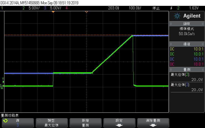

PD5V/9V15V can be successful.
But PD20V will be wrong because UnableToSource, as shown below
Purple Line PortA VBUS
Green Line PortB VBUS
I guess it is Timeout.

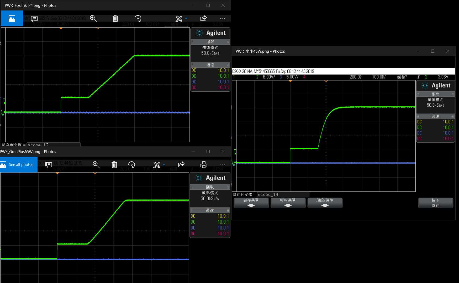

  • PD5V/9V15V can be successful. below is PD15V.
  • Hi Eric,
    It looks like the 20V does not ramp in time to meet the PD Specification. Is there any way you can increase the ramp on the 20V Supply? I noticed the dV/dT looks the same for the 15V case, so the timing can be met since the voltage does not need to go as high. However, for the 20V case, the timing is not met as the ramp from 5V to 20V is taking too long. I would suggest increasing the ramp rate of the 20V supply to resolve your timing issue.
    Thank you,
    Eric

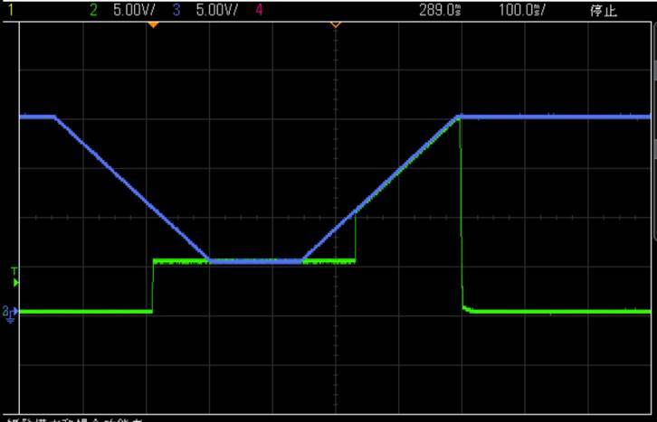

  • Dear Eric(B),
    We have three brands Adapter on hand.
    1. P4
    2. GrenPlue 65W
    3. Millet Type C
    Compare them about 100ms~250ms
    Testing
    Make PortA PDO normal at 9V, climb to 20V, save some time
    But as things get more, they find other problems.
    Top left: 9V to 20V success
    Top right: 9V to 20V failure (UnableToSource)
    Bottom left: 5V to 20V failure (UnableToSource)
    Bottom right: 5V to 20V failed with fast Adapter (UnableToSource)
    1. Is it possible to speed up the TPS65988 response?
    2.  What is error reason both right picture
    3.Or other suggested ways
    Thank you
    Eric Hung
  • Hi Eric Hung,
    Can you maybe share a block diagram of your setup? It would help me to understand the application and exactly what you are trying to do with the TPS65988.
    As far as speeding up the response of the TPS65988, we cannot change this timing. The TPS65988 is PD compliant and certified. All relevant transition timings are following the USB Power Delivery specification and adjusting these timings would break that compliance.
    For the error reason for the images on the right, it looks like there may be a large current spike occurring causing the TPS65988 to go into Over-Current Protection. It looks like the adapter VBUS is dropping a lot when the Power Path in the TPS65988 is closing. If you could measure VBUS current during this event, it would verify what I am thinking.
    Thank you,
    Eric
