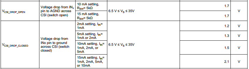

3. What does below maximum voltage mean? According to CSI current 2mA, IN pin voltage shoule be 2mA*5k=1V<2V, if CSI current is 10mA, it should be 10mA*5k=5V>1.7V.
    The maximum voltage drop across the current sink makes sure you configure the threshold above the maximum voltage drop. When the switch is open, the voltage drop will be 1.7V as shown in the in the datasheet table above.
    When the switch is closed, the voltage drop will what you calculated in  bullet No.2.
    The spec in the datasheet refers to the matrix use case where you have higher current sink setting but actual current flowing in INX pin is limited by the current source.

    3. When the switch is open. Will the IC break, If the voltage of IN x is more than 1.7V?  what is function for VCSI_DROP_OPEN or VCSI_DROP_closed?
    No the IC will not break.
    VCSI_DROP_OPEN is maximum voltage drop across the current sink in a switch open (RSW(MIN) = 5kohm) scenario. The comparator threshold settings (2V, 2.7V, 3V, and 4V) are all above 1.7V so there shouldn’t be any issue distinguishing an open (INx voltage between 0 and 1.7V) vs. closed (INx voltage is pulled up close to the battery level) switch.
    VCSI_DROP_CLOSED is a spec for the Matrix mode operation (Refer to the datasheet). In Matrix mode, both the current sink and current source are turned on together, and there will be certain voltage drop across the current sink depending on the setting used. This spec is not relevant to your particular use case.
