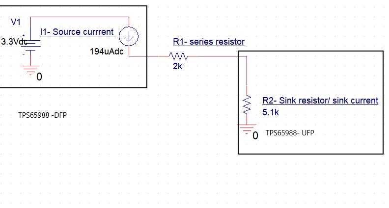

The application i am working will be using 5V and 1.5A.
TPS65988 has internal current Source referred the table 6.8 for the datasheet For 1.5A.
Can you help me find the Pull up values and pull down value for same
