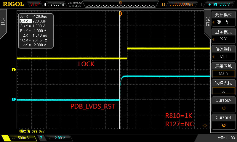

DS90UB927Q-Q1: When ds90ub927q-q1 is turned on, it appears a flower screen, which will grounding PBD and eliminate the phenomenon;
Part Number: DS90UB927Q-Q1
There are two questions,
1. Is the time of tPLd set by software or determined by the chip?
2. Does PDB lag VDD? If so, how long does it lag?
