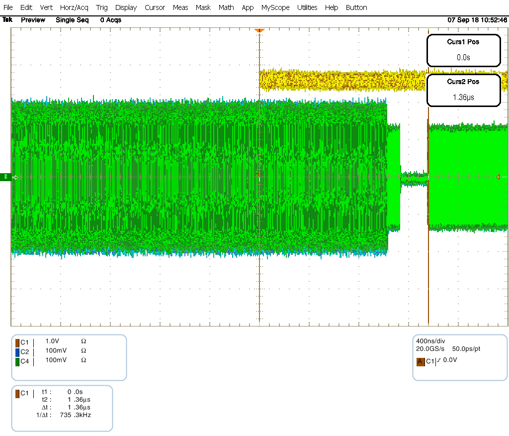

With Mode 1 (Ch A and B Reg_0x07[5]=0), my customer found some bit errors after acting switching operation with MUXSEL. However, with Mode 2 (Ch A Reg_0x07[5]=0, Ch B Reg_0x07[5]=1), there was no bit error. For cross-point operation, there should be channel interruption. I think the interruption time of Mode 2 might be shorter than Mode 1, so no bit error happened. Could you pls take a look at this? There is no switching time data in datasheet.

  • Hi Jerry,
    The total switch time is just over 1uS (measured at 1.36uS) with the pin control.
    I have attached a graphic which shows the change in signal at a high level.  There is a period of time when no signal is present at the output.
    Lee
