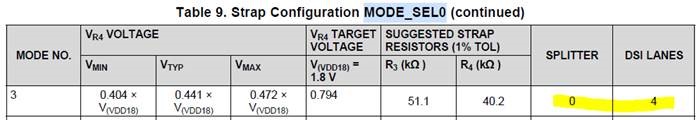

Currently, there is a problem with the debug DS90UB941AS-Q1, the deserializer ID can be read, but the FPD link cannot be locked, probably in the DSI input section.
LCD resolution is 1024 x 600. single DSI. STP cable.
Is there a sample code of DS90UB941AS-Q1 initial and HW setting recommendations for reference?
In addition, in the DSI Indirect Register, what settings need to be made in addition to TSKIP_CNT?

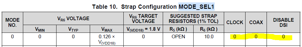

    - MODE_SEL strappings
    => Mode_sel0
    => Mode_sel1

  • Hello
    yes, the Tskip_CNT must be set dependent on the DSI clock freq.
    in your case, pls check if the reg. 0x56 selects the correct clock source or not, also, please set the Tskp_cnt with below register setting.
    WriteI2C (0x40,0x04) //Select DSI Port 0 digital registers if this is your use case
    WriteI2C (0x41,0x05) //Select DPHY_SKIP_TIMING register
    WriteI2C (0x42,0x09) //Write TSKIP_CNT value for 153.6 MHz DSI clock frequency (pls check d/s on this calculation)
    beside, pls measure the DSI input clock signal and dump 941as registers for further analysis if Tskip_cnt can't resolve your issue.
