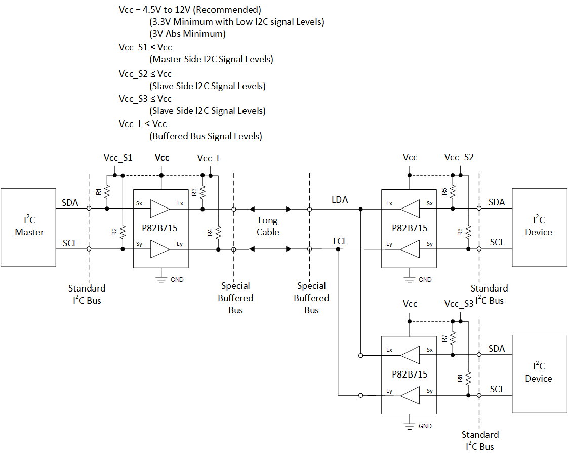

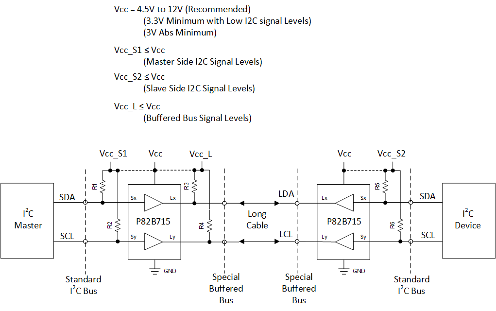

Hi:
I want to use TI P82B715. Please help me with the following questions:
1.Can the transmission distance of chip B82B715 I2C reach 1.5m?
2.At a distance of 1.5 meters, I used several of the device drivers?In addition, is the driver side or the load side more appropriate to use?
BR
Rain
