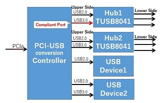

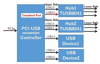

  • We have 2case. Hub1 or Hub2 into compliance mode.I atatched a Yellow bang screenshot that are 2 board.
    I make an block diagrames for compliance mode. Red arrow potion is compliance mode. Register of Host controller indicate compliance mode.
    And I found that Windows also indicates a compliance mode. Please see the attached screenshot.

  • Hi TK,
    Ok, thnak you this helps confirm the information you gave earlier.  The host downstream facing port enter compliance mode.  You noted that changing the power on reset timing to the hub does not impact the issue.  Can you change the USB_VBUS input to the hub so that it is not powered while the OS loads?  How is the design different on the port where TUSB8041 appears correctly?

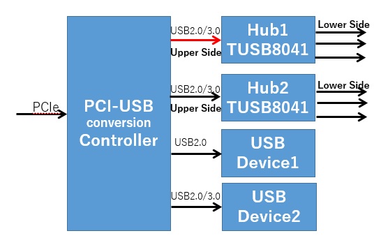

  • Hi JMMN
    My explanation was not enough so I update the diagrams. It is only Super Speed port disapeared.
    I connected the USB_VBUS(Pin48) with hand after OS boot.
    Some times recognized the  superspeed port from OS.
    Original USB_VBUS  is connected to 5Voltage through a 90.9-KΩ ±1% resistor, and to ground
    through a 10-kΩ ±1% resistor from the signal to ground. 5Voltage is on the board.
