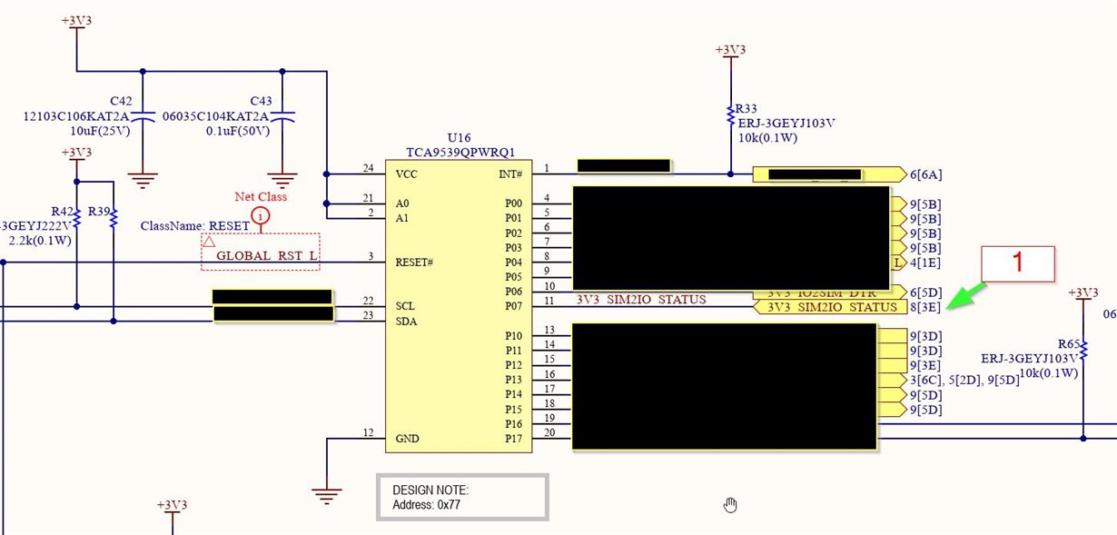

  • This is the schematic.
    1. We measured the voltage on the point 1 in the picture. it's is 0.7V.  Then we read it from I2C but the data on P07 is '1'.
        We got the correct data on the other ports.
        We already short the P07 to GND and the data from I2C is '0' which mean we can read the data on  P07.
    2. The source which drive P07 is direct from SN74AVC2T245RSWR. We use this one to translate 1.8V to 3.3V
    3. We think we set the register correct because we can read the data when we short the P07 to GND.
  • Hey Nopphen,
    Thanks for the image and additional information. If that is what you are seeing then I wonder if the device could be damaged.
    How many boards/units are you seeing this with?
    Can you test by removing the device and repopulating another TCA9539?
    Can you put the removed device onto another board and retry?
    Are you able to check to see what the consumption current of the device is?
    Is it possible that you set the device to be an output high and then applied 0.7V at the pin?

    I want to double check that the device is set as an input and not as an output by mistake. If you set it as an output high and SN74 drives low, it would potentially damage the device which could potentially explain why we are seeing this.
    Also, is there anything else on pin 11 at all? I know you're saying there is an sn74 but are there any pull up/pull down resistors?
    -Bobby
  • We connected P07 direct from SN74AVC2T245RSWR without any PU PD.
    We still don't know why TCA9539  can't detect 0.7V to be low.
    But we found the solution to solve our problem.
    the problem is SN74AVC2T245RSWR. At the time which we need to detect signal, the power 1.8V was disappear. So the chip sent out 0.7V because of the wrong working condition.
    Then we PD on the  3V3_SIM2IO_STATUS which make the voltage to be 0V and the TCA9539 can detect it.

  • Hi Nopphon,
    Thanks for the update, and I'm glad you found a solution.  Please let us know if you decide to investigate further on the TCA9539 behavior.  It sounds like SN74AVC2T245RSWR's output would be high-impedance when it is unpowered.  Since the voltage is floating, maybe it is measured to be 0.7 V when some test equipment is connected (such a voltmeter) due to the equipment's input resistance but is seen to be higher by the TCA9539 when nothing else is connected.
