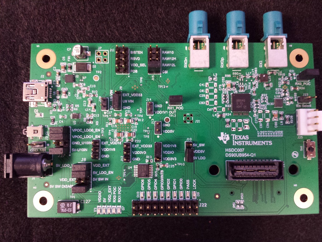

I have a DS90UB954-Q1EVM board communicating with a 953 serializer in a camera, connected through a Fakra connector to J29. The device is locked.
The DS90UB954-Q1EVM board appears to stop communicating with ALPS when the J16 VDDIO voltage select jumper is set to VDD3V3 3.3V.
The user guide indicates Pin 1-2 are shorted together to use 3.3V as the default, but my device was received with pins 2-3 connected, to use 1.8V.
At 1.8V, ALPS correctly identifies the connected serializer as a 953 and locked. If the jumper is moved, the app hangs until the 1.8vio is restored.
If the app is started with the jumper set to 3.3V, it identifies the serializer as 913, and not locked, despite the lock LED D9 glowing.
I would like to use J25 to connect to I2c using 3.3V instead of 1.8V. Other EVMs work at 3.3V i2c.
J25 is not currently connected to any external device.
I have consulted hsdc007_reva_evm.pdf for the updated schematic with the wiring of I2C connector J25 (opposite of Table 6) and J16.
