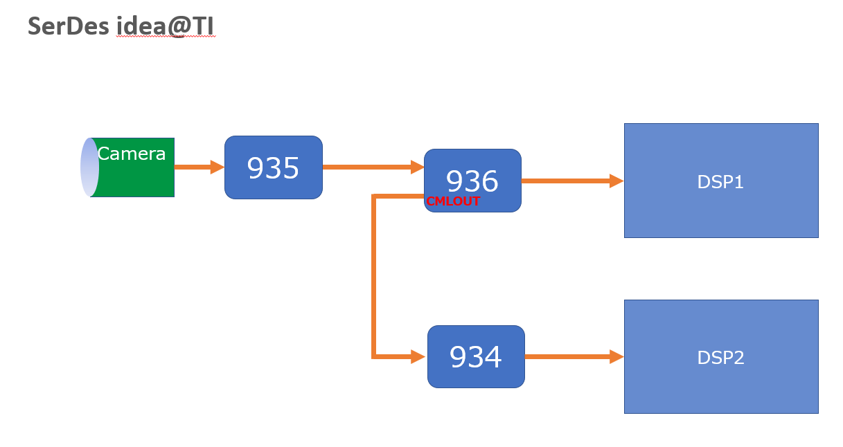

Hi Sir,
I want to realize the following configuration.
Camera has 1.8MP.
I have 2 questions.
question 1: Can 934 receive the FPD-link signal from CMLOUT pin in 936?
question 2: How much delay order is between Camera to DSP1?(micro-seconds order?)
I hope this question find you:)
  • Hello Shim,
    Thank you to touch TI. we're glad to help you on FPD-Link questions.
    1. Sorry in your block diagram, UB934 can't be used as the link between UB935 and UB936 works at CSI2 mapping while UB934 only can work at DVP mode, these two are not compatible. you can use UB936 to replace the UB934 for such application.
    2. The latency between UB935 and UB936 is about dozens of us level (<100us) dependent on the line length.
