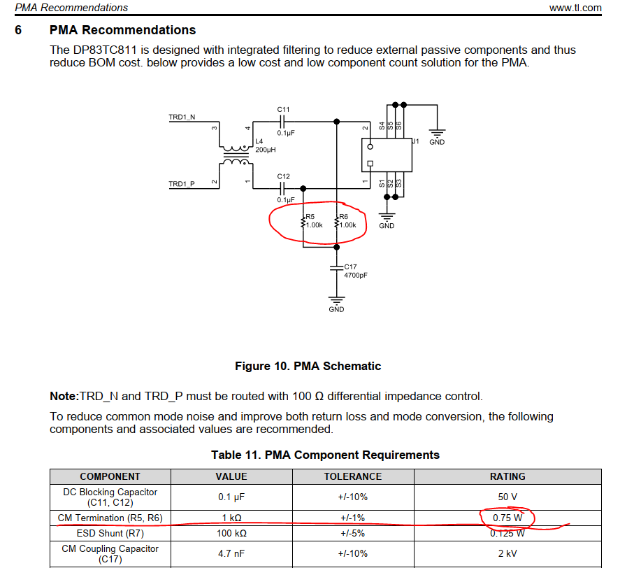

DP83TC811R-Q1: PMA recommendation circuit question
Part Number: DP83TC811R-Q1
Other Parts Discussed in Thread: DP83TC811-Q1
About the PMA schematic of DP83TC811-Q1 , the application notes(http://www.ti.com/lit/an/snla292/snla292.pdf) recommend the power of CM termination resistor 0.75W while the EVM  user's guide recommend 0.1W. So which is better?
While the EVM user's guide is as following:
