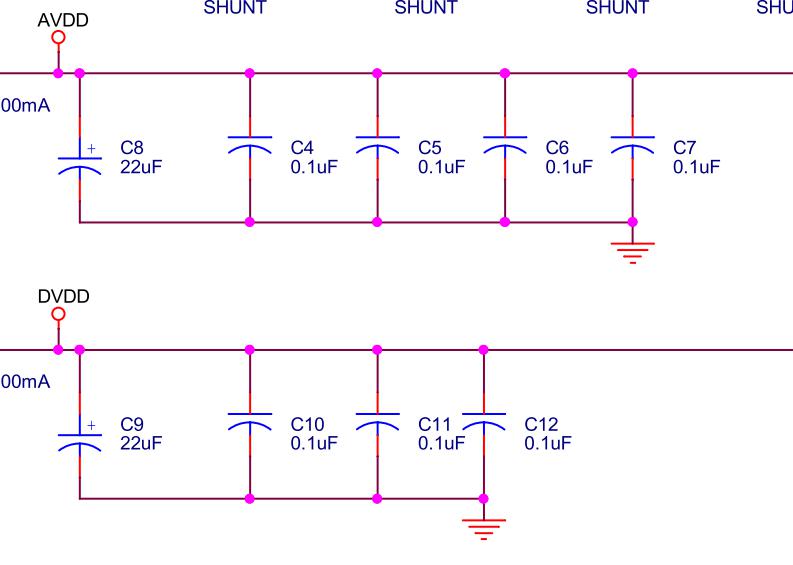

On the datasheet, "small" power supply capacitors is recommended 0.01uF at "11. Power supply recommendations".
On the other hand, these are 0.1uF on the EVM as below.
Which capacitance should we select?

Hi Kuramochi-san,
Either is fine, but I would recommend following the EVM schematic since it's been verified as working in the lab.
