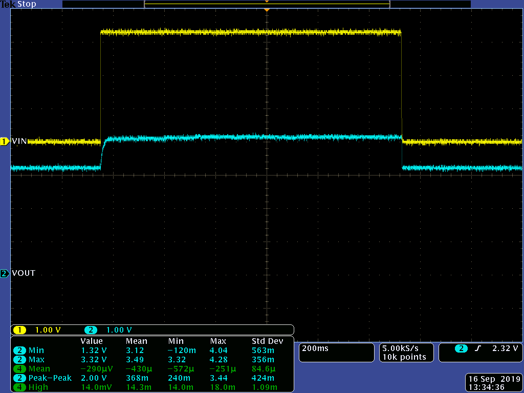

Hi Team
            I have use I2C to updata PD FW. I have use TPS65988DJ HRESET pin for reset PD. but I find the hesrt pin from high to low. The chip did not reload SPI flash.
            Can I use HRESET pin to do re-load SPI flash function?
            The file  CH1 : HRESET / CH2 : SPI CLK
             If chip have reload code , The CH2  have some data.
I know for re-load coed can use 4CC GAID, but I want know Hreset pin function is chip reset or re-connector ?
