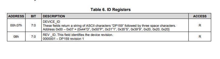

3. As below pic, we can be seen coming to our ADDRESS at 01 (BA), then the value is 00110001. We have a problem with [1:0] changing from 2’b01 to 2’b10.
4. We would  like to know about the difference between 01 and 10?
5. Where is the difference in the address setting?

    2. It looks like you are able to correctly dump out the DP159 registers since the Registers 0x00h to 0x08h dump out the correct Device_ID and Rev_ID.

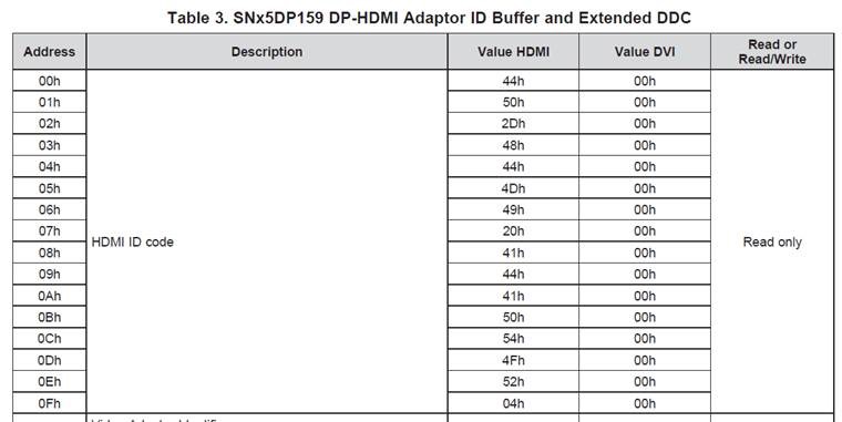

    0x00h to 0x08h spec is show I2C register, please refer as below
    But in the front is the Extended DDC register.
    Both of them are same?
  • Shu-Cheng

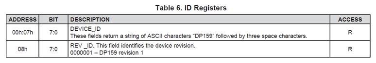

    No. Here is the DP159 ID Register
    The DP-HDMI adapter buffer and extended DDC register for Type 2 capability is accessed at target addresses 80h (Write) and 81h (Read). The capability and control registers are mapped to DDC address space. The registers are accessible using I2C-over-AUX transaction support or through DDC signaling.
