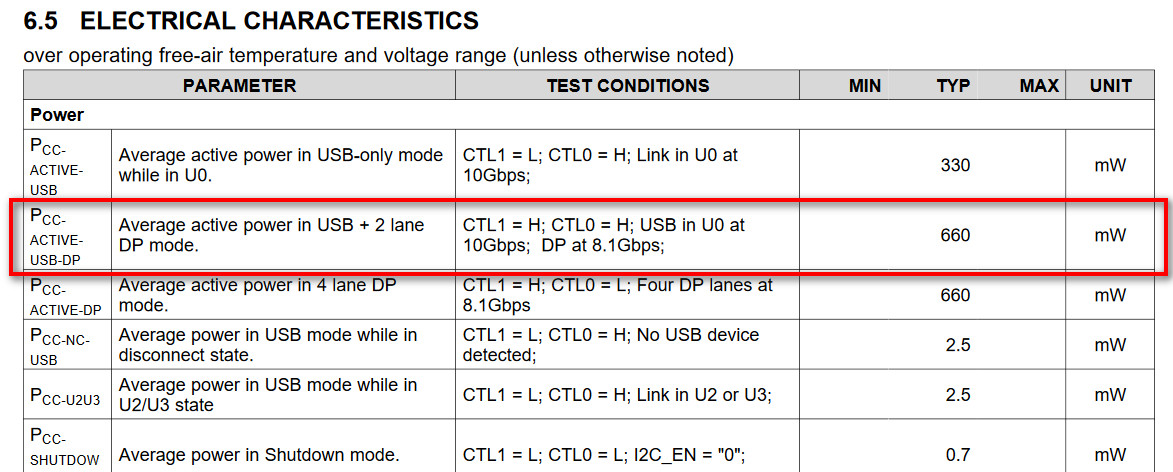

hi sir:
Customer test TUSB1064 power consumption, and test result over Spec typical value. (3.21V / 226mA)
please help check the Maximum value of TUSB1064 power consumption.
