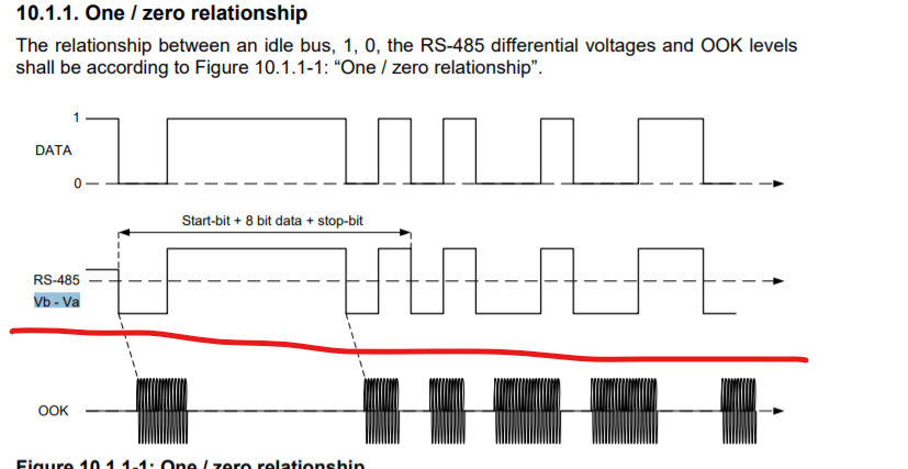

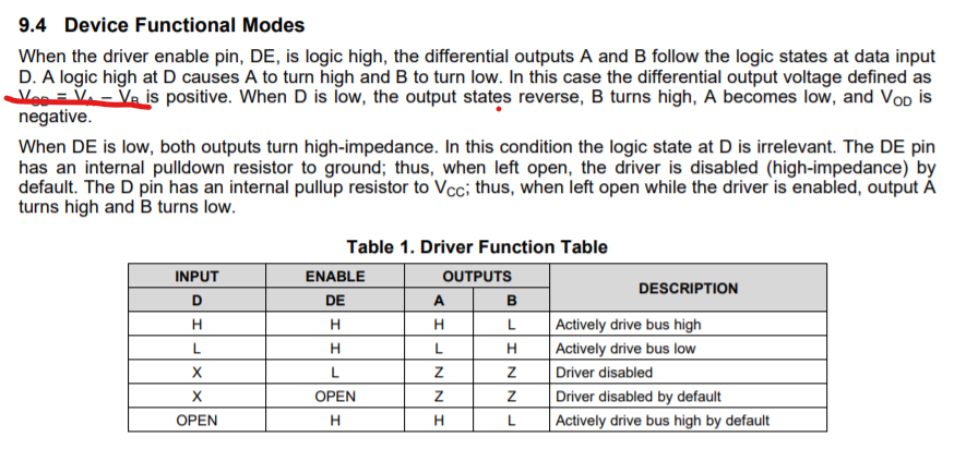

In SN65HVD72 datasheet, it defines Vod=Va-Vb. see the below.
However, for AISG3.0 standard, it defines Vod=Vb-Va. see the below.
https://aisg.org.uk/files/AISG-Base-standard-AISG-v3-0-2-1.pdf
If the definition of Vod is reversed, the connection will be reversed.
Can you clarify which definition is correct? Or both are correct?

    The naming convention for RS-485 can be kind of confusing.  The RS-485 standard defines A and B lines so that the bus is considered in a “binary 0/ON” condition when VA is greater than VB and in a “binary 1/OFF” condition when VB is greater than VA.
    However, pretty much all RS-485 transceivers for the last 30+ years have followed a seemingly opposite convention in their pin naming: a logic high signal applied to the transmitter input results in a positive differential voltage from A to B (i.e., VA > VB) and a logic low signal applied to the transmitter input results in a negative differential voltage from A to B (i.e., VB > VA).  (The receiver logic works in the same way.)
    For this reason, most applications use the “A” pin of the transceiver (i.e., the non-inverting bus input/output) to represent the “B” line that is described by TIA/EIA-485 and vice-versa.
    So, I believe the differences you are seeing between these two documents are just a difference in naming and you should not need to reverse the connections.
