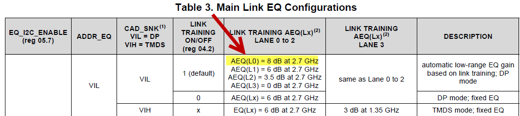

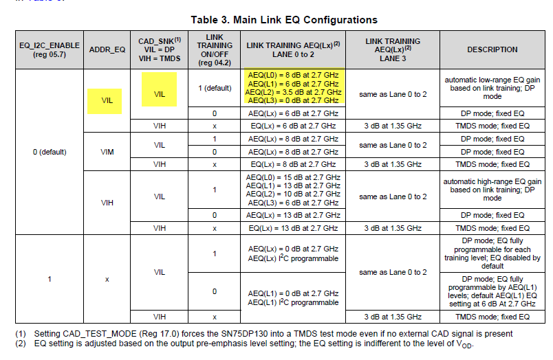

We have use DP130, our design as below.
There is no software to control the SN75DP130 register,
We want to know what is the actual EQ compensation of the SN75DP130 after link training? ?
We can access the SN75DP130 normally through the debug mode (the external development board is connected to the SN75DP130).
So how could we check the the EQ value after link training?? and which register??  0dB,3.5dB,6dB,8dB?
