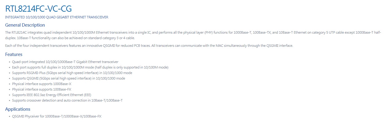

RTL8214FC-VC-CG replacement
Hi Team,
Does TI has any device to replace it?
Thank you,
