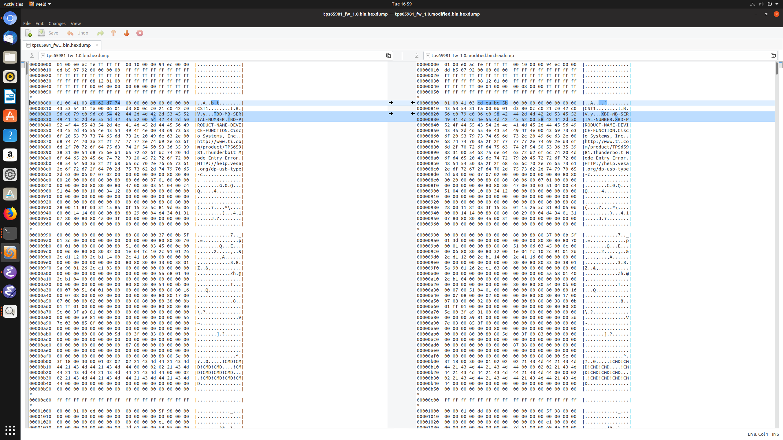

    If you look at the image below:
    On the left side of the image is the serial number string set to "TBD-MB-SERIAL-NUMBER" starting at 0x826.
    I thought I could just change that string during programming of the flash.
    However, when I change the serial number in the "Application Customization Tool" it also changed some data at 0x804. Maybe a CRC ?
    On the left side I have changed the serial number to "XBD-MB-SERIAL-NUMBER", now the data at 0x804 also changed.
    Is there a way I can change the serial number string and update the magic number at 0x804 accordingly in SW during firmware update.
    I have tried to generate CRCs on different parts of the firmware binary but can't figure out how to ? Or what region is used ?
    Martin
    Should read:
    On the right side I have changed the serial number to "XBD-MB-SERIAL-NUMBER", now the data at 0x804 also changed.
    Martin

    I'm sorry but I can't find any detailed information about the how to update a serialnumber in the firmware binary in the app note provided.
    I have however after a lots of trials and errors been able to figure out how to calculate the crc in the userconfig-area of the firmware.
    See my post from 22. Oct:
    The userconfig-area starts at 0x800.
    The actual length (u16) of the userconfig-area is found in bytes 0x802 -> 0x803: len = 0x341.
    The crc (u32) is at 0x804 -> 0x807.
    The crc is calculated over 0x800 -> 0x803 and 0x80c -> 0xb41.
    (for some reason is the four bytes between 0x808 -> 0x80b not a part of the crc).
    I can now patch the firmware during programming with a serialnumber per unit and re-calculate the crc.
    I attach a code example in case someone else see the need for this.
    Martin
