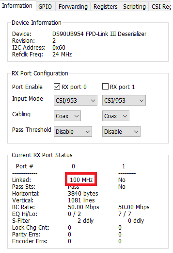

Hi Sir,
Recently I used the MAP function in the ALP.
Could you tell me what does the 100MHz mean in the picture below?
Thank you!

the 100MHz is gotten from the line rate. If the FC rate is 4Gbps based on the clock mode setting (refer to d/s on the clock mode and FC rate setting), then the link clock is: 4Gbps /40btis = 100MHz. Pls note this is NOT the PCLK.
