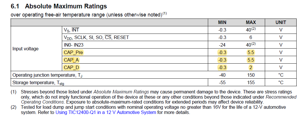

What is the Vmin/max spec at the following pins?
- CAP_A pin :
- CAP_D pin :
- CAP_PRE pin :

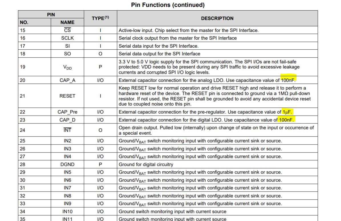

Thank you for your reply. The customer's question was just the capacitor's voltage rating for those pins because TIC12400-Q1 EVM uses the big voltage ratings of 0.1uF/25V for CAP_A, D and 1uF/50V for CAP_PRE although the max voltage at the pins is 5.5V. I'm not sure if it can be reduced as smal value.
