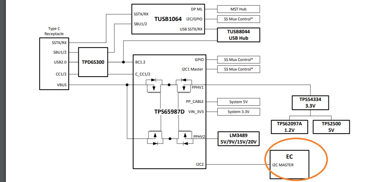

Hi Sir,
We read the 8.3.9.2 I2C page of TPS65987D, but sorry confusing the chapter still,.
could we  connect (I2C-1) to DSP  and (I2C-2) / (I2C-3) to charger as like the portable speaker ?
or I2C-2 is claimed to thunderbolt only ?
Which GPIO (IRQ ? HPD ?)was necessary for portable application ?
what`s the meaning of "EC" ?
