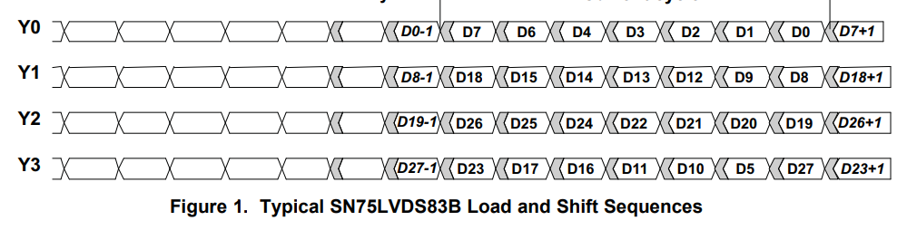

    You should compare Figure 1 in the SN75LVDS83B datasheet:

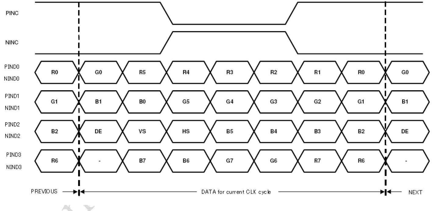

    with the corresponding input format illustrated in the display datasheet.
    For example, if the input format illustrated on the display datasheet looks like the below:
    then you would map input pin D0 on the SN75LVDS83B to bit R0, D1 to bit R1, D2 to bit R2, etc.
    Note that this is a hardware setting as the format is determined by how the input pins on the SN75LVDS83B are connected to the output pins of the processor.
