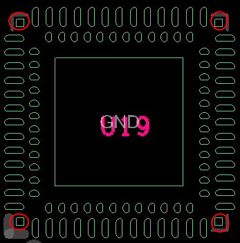

Is the four corner's pad need to soldering?

The corner pins, which are for mechanical stability of the package, are connected to ground internally. These pins may be connected to VSS or left unconnected.
David
App note on building with RKM package devices: http://www.ti.com/lit/an/szza059/szza059.pdf
