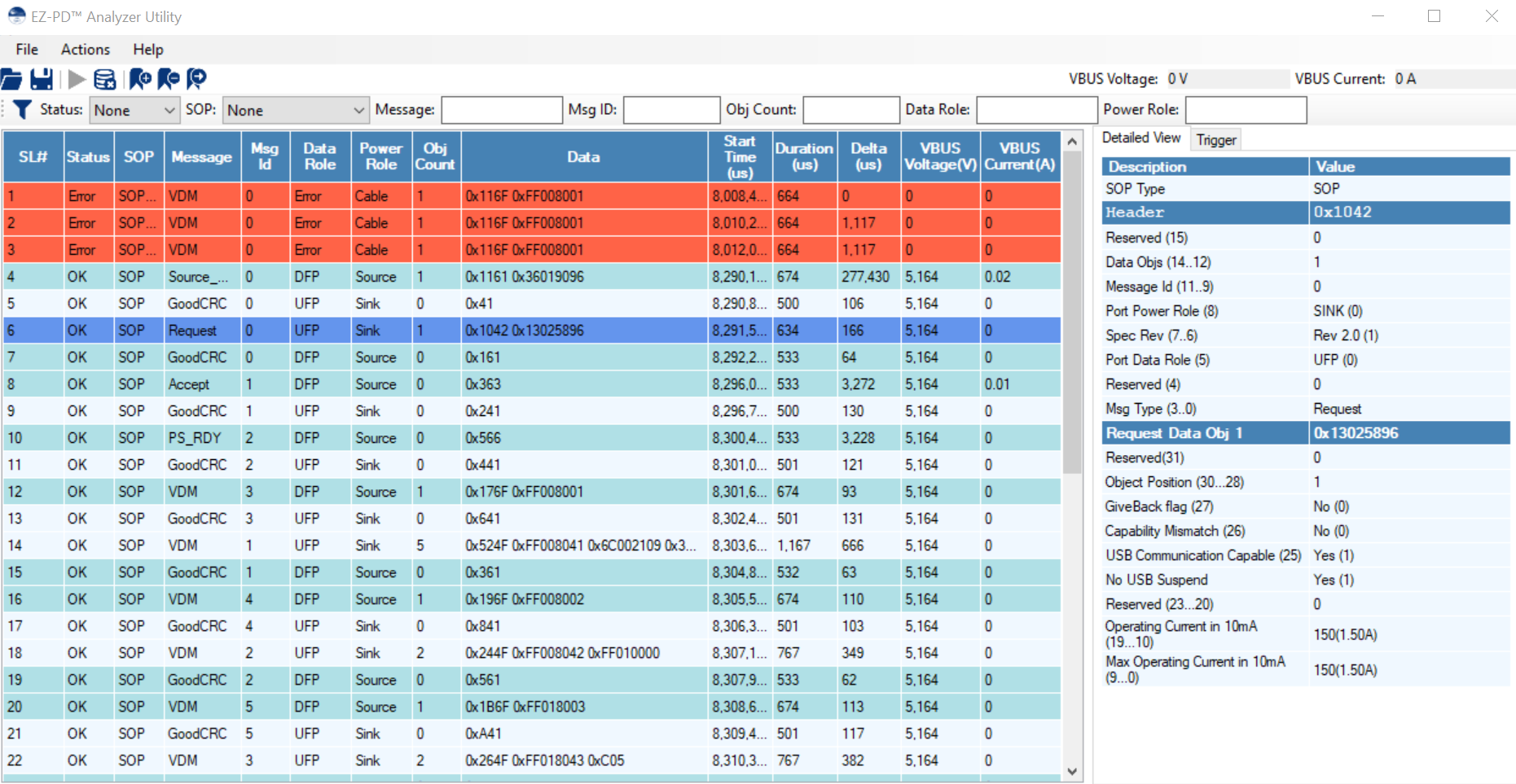

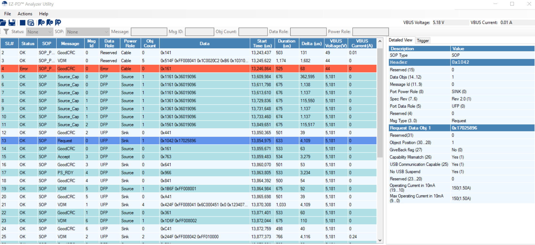

    I've looked over the PD messages and I've noticed a difference between the adapter, which does work OK and the EVM. The first message from the sink, after the goodcrc is a request. When the adapter makes this request it is 0x13025896, but the EVM is 0x17025896. The only difference is that the EVM has the capability mismatch flag raised.
    Do you know why the flag would be raised on one and not the other, when essentially they are requesting the same PD object? And is there any way to have control over that flag manually?
    The other message that is different is the DFP VDM giving details of the DP capabilities. The EVM advertises its UFP pin assignments as C & D and nothing supported for DFP, as per the TI recommendations. The adapter basically shows the opposite, with C & D available for DFP and nothing for the UFP. If I set the EVM to these settings, it doesn't display DP on other sources, like a laptop. This makes sense as I understand those setting being for a DP source, not  sink.
    After this message, with the EVM connected, the S8 responds the a get_sink_cap message, whereas the adapter is responded with another VDM message relating to DP.
    I'm guessing the reason the S8 doesn't engage further in the DP contract with the EVM is something to do with the power contract.

  • Hi Eric
    Thanks for the quick response.
    I started by changing the EVM sink capabilities to match the adapter sink capabilities. This is how the 2 request messages are the same apart from the mismatch bit.

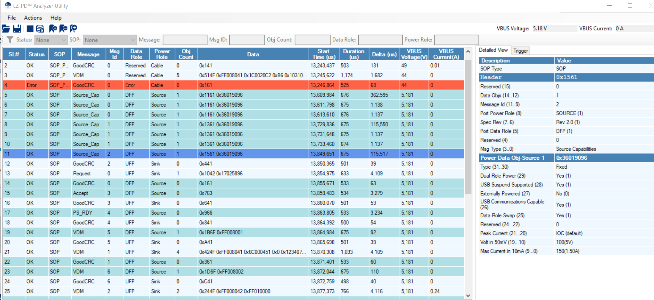

    I have a PD analyser. I am using the Cypress CY4500. I have attached 2 files in a zip from that analyser. I'm not sure if you already have the software for it or not. In case you don't, I have attached some screenshots of the messages in question.
    I understand that maybe the S10 has resolved these issues but what is keeping us going with the S8 is that other consumer products are able to work without issues with the S8. I have attached the PD analyser results from the TP65987EVM connected to the S8 as well as the adapter product connected to the S8. The adapter I have is a kingston nucleum, which uses a VIA tech VL101 PD controller.
    With the capability mismatch bit, do you know what parts of the PDO need to match? Is it the entire PDO, with every option bit being the identical, or is it just the voltage and current usage?
    0363.USB PD captures.zip
  • Hi Laurence,
    After looking at the PD logs, I don't think this issue is related to the capabilities mismatch bit. The power negotiation looks ok and the Cap. Mismatch bit should not cause adverse effects. After checking out the logs, I looked at the project file that you sent. It looks like in the Display Port Capabilities register, you had set the DP Receptacle Indication set at Plug. This should be set to Receptacle if you are using the TPS65987EVM.
