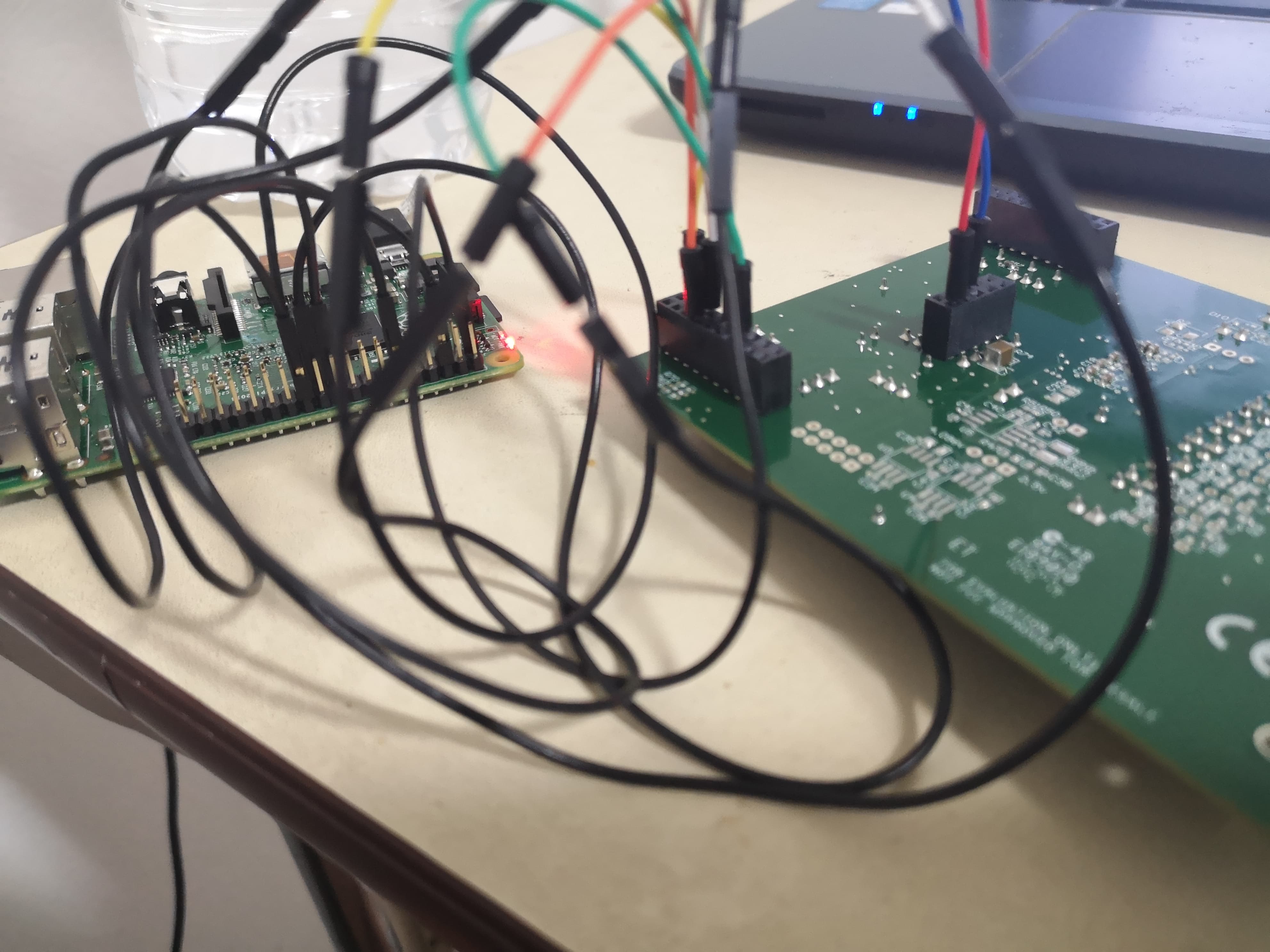

I am a newbie and recently doing my project with ADS1298 and trying as first step to power the ADS1298EVM (without MMB0) by Raspberry Pi 2 Board (I am not sure if it is possible?). Im trying to build SPI between them (ADS as Slave, Raspberry Pi as Master). But i didnt get the result that i expected when i read the ID device. My SPI connections look like this:
Raspberry ADS1298EVM
3.3V ----- Pin 9 (on J4)
GND ----- Pin 6 (on J4)
Pin 23 (SCLK) ------ Pin 3 (CLK) (on J3)
Pin 24 (CE0) ------- Pin 7 (CS) (on J3)
Pin 19 (MOSI) ------- Pin 11 (DIN) (on J3)
Pin 21 (MISO) ------- Pin 13 (DOUT) (on J3)
Pin 12 (GPIO 18) ------- Pin 8 (RESETB) (on J3)

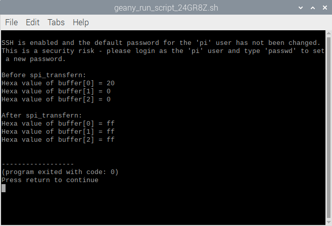

But i only get this rerult :

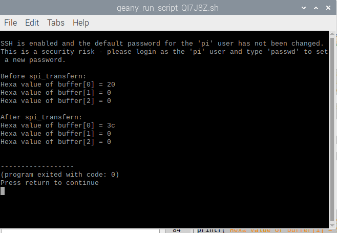

And then this when i took the 2 power connections out from Raspi to J4 on ADS1298:
It seems like the value changed sometimes somehow when i connect and reconnect the 2 power wires to J4. As prove i have got this result after i put the power wires on J4 again:
