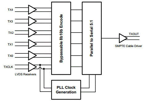

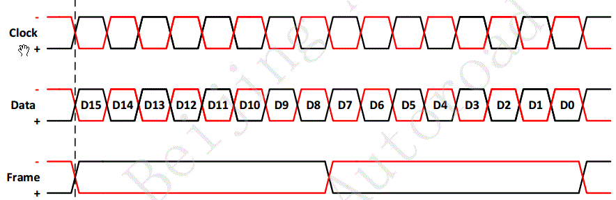

I would like to transmit raw ADC LVDS data through cable for about 5 meters,ADC output data is 4 channel LVDS with one FRAME,output clock is 200MHz DDR:
I need to convert parallel LVDS data to serial to easy connecting,is LMH0340/LMH0341 a proper choice ?
