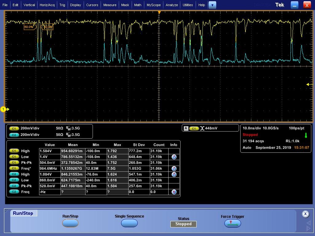

We observed that if all IN0 - IN4 LVDS inputs are all 0 V (no signals), OUT0 - OUT4 output channels will have behaviours as below:
a.) OUT0+ 1.3 V flat, OUT0- 1.1 V flat.
b.) OUT1+ and OUT1- both 1.2 V flat.
c.) OUT2+ 1.1 V flat, OUT2- 1.3 V flat (polarity inversion compared to item a.)).
d.) OUT3+ 1.5 V flat, OUT3- 0.9 V flat (larger peak-peak compared to item a.)).
Why the 4 output channels behaviour will be different among each other?
We try to setup the above 4 conditions to be connected to IN0 - IN4 this time, and the observations as below:
a.) If any IN+ and IN- have both 1.2 V flat (common), OUT+ and OUT- on that particular channel will surely have signals flipping.
b.) If any IN+ and IN- in LVDS differential form, OUT+ and OUT- on that particular channel will follow what the input be.
c.) Channel 2 will always have polarity inversion.
d.) All channels output peak-peak value will increase. OUT+ 1.5 V, OUT- 0.9 V.
Why common 1.2 V signals will cause signal flipping? Why channel 2 always have polarity inversion?
    The input threshold is typically ~ 0V differential.  So if the input is allowed to float the output state can not be predicted.  When there is no differential input on a channel, using PWDN to reduce power will mute the output.
    Alternately, biasing the input differential pins to a slightly positive or slightly negative bias (~25mV) can help to stabilize the device output when no input signal is present.
