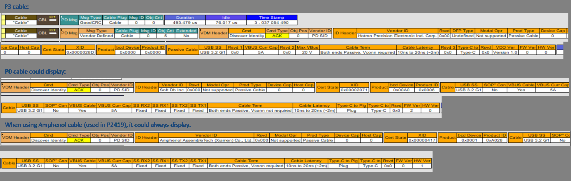

My customer is connecting a notebook to the monitor (using our TPS65987DDJ) with a particular cable and it always could not display.(other cable did not have such issue)

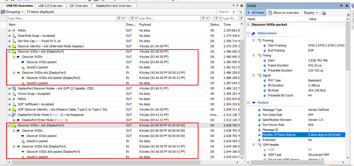

after the initial VDM discover identity, SVID, and notebook issue Enter mode request, but PD did  not ACK. after ~ 120msec, the PD re-issue Discover SVID, but this time, it send the number of object code = 2.
Shouldn't be the SVID request is alway with 1 object (as in teh first request)?
Will our TPS65987DDJ able to response properly when the SVID request is with 2 object?
Shouldn't we expect the notebook to continue to send out request commend (discover mode request)?
