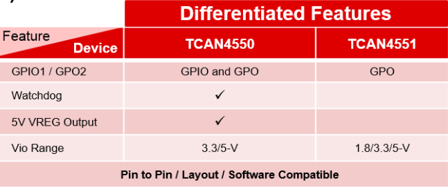

Hello Oliver,
Here is a comparison table of the differentiated features between the two devices.
Generally speaking, the TCAN4551 is a reduced feature version of the TCAN4550. The watchdog and 5V LDO output have been removed from the device and the GPIO "Input" features have been removed and only the "Output" configuration for those pins are available on the TCAN4551. The last main difference between the two devices is the VIO range for the TCAN4550 is 3.3V to 5V and support for 1.8V MCU's has been added for the TCAN4551 allowing for a 1.8V VIO to be used.
I'm not sure what trace length you are asking about? Are you asking about the trace length between the MCU and the TCAN455x on the SPI bus? If so we don't have a specification for this and it is related to the signal amplitude between the MCU and TCAN455x device. As long as the signal amplitude crosses the 0.7*VIO High threshold, and the 0.3*VIO Low threshold, the communication should work. These thresholds may differ between the MCU and the TCAN455x devices so both device specifications must be met.
The CAN transceiver is built into the TCAN455x device and there is no need to add a CAN transceiver. This is the main feature of this device. Simply connect the TCAN455x to the MCU with a SPI bus, and the TCAN455x pins to the CAN bus.
