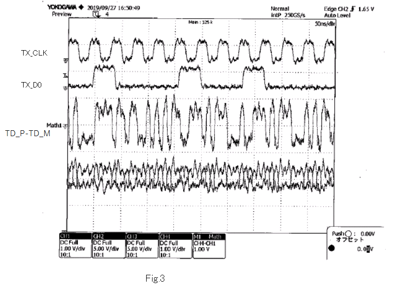

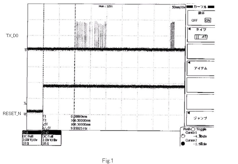

Please refer to Fig.1 ~ Fig3.
Fig.1 shows that it is accessed 100.5ms after reset release.
Fig.2 shows that the TD_P-TD_M signal is not output even if the TX_D0 signal is output when accessed 100.5ms after reset release. (In case of abnormality)
Fig.3 indicates that the TD_P-TD_M signal is output when the TX_D0 signal is output when accessed 10 seconds after reset release. (Normal)
Why is the TD_P-TD_M signal not output even though the TX_D0 signal is output when accessed 100.5ms after reset release?

    TD-P/M is not showing idles because the link might not be established. TX_D0 is controlled by the MAC, so the MAC might be trying to send the data when link is down.
