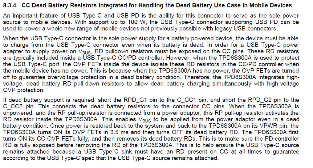

  • Hi Hari,
    I have a theory as to why my smart adapter might not be cooperating in the sense that the 5V rail is never coming up - I am using the same protection circuit as the Eval board, the TPS6S300A.  Unlike the Eval board however, in my circuit, I did not connect the RPD pins to the CC pins on that protection IC.  My thinking at the time was that my main PD controller, the TPS65987D already was taking care of the RPD pull down resistors in the dead battery mode and I didn't want two sets of these resistors in parallel.
    What I now believe is happening is that since the TPS6S300A has internal switches that prevent the CC lines from reaching the PD controller chip until the part is powered.  Since this protection chip derives its power only after the Vbus turns on (and it never does), these CC lines never get the benefit of the Rpd resistors that are built into the TPS65987D.
    Therefore, it appears the Rpd resistors must come from the TPS6S300 since it is the only impedance presented to the connector before power is applied.
    I will try connecting that path to see if that gets my smart adapter back up and running.

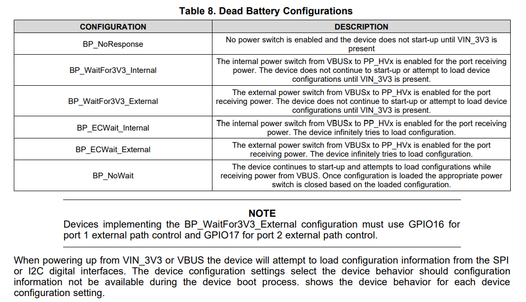

  • Hi Aaron,
    To get back to you, no I am saying that the preconfigurations will load into the application, however, I see on the datasheet that since you are also using the BP_NoWait dead battery mode configuration, then it will depend. I will include a screenshot below of the part I am referencing in the datasheet, it is in the last paragraph.
    As far as receiving the 15V contract, I will continue to look into your setup to understand the functionality and get back to you on that.
    For the TPD6S300A however, yes I think you should be connecting the RPD pins to CC pins on that as well. In a dead battery condition, the OVP FETs on the TPD6S300A are turned off for protection, so with the PD controller also in dead battery, they should be connected. Below is a paragraph from the datasheet explaining a little better and in detail the functionality.
    Were you able to test this and see the results?
    Thank you,
    Hari
  • Thanks for sending me that explanation and the reference in the datasheet for using the protection IC.  After I connected in the Rpd feature on the protection IC, I did get the power path to turn on.  Thanks for continuing to search on the ability to negotiate a sink contract for >5V from PD controller at boot time without SPI or I2C intervention.
