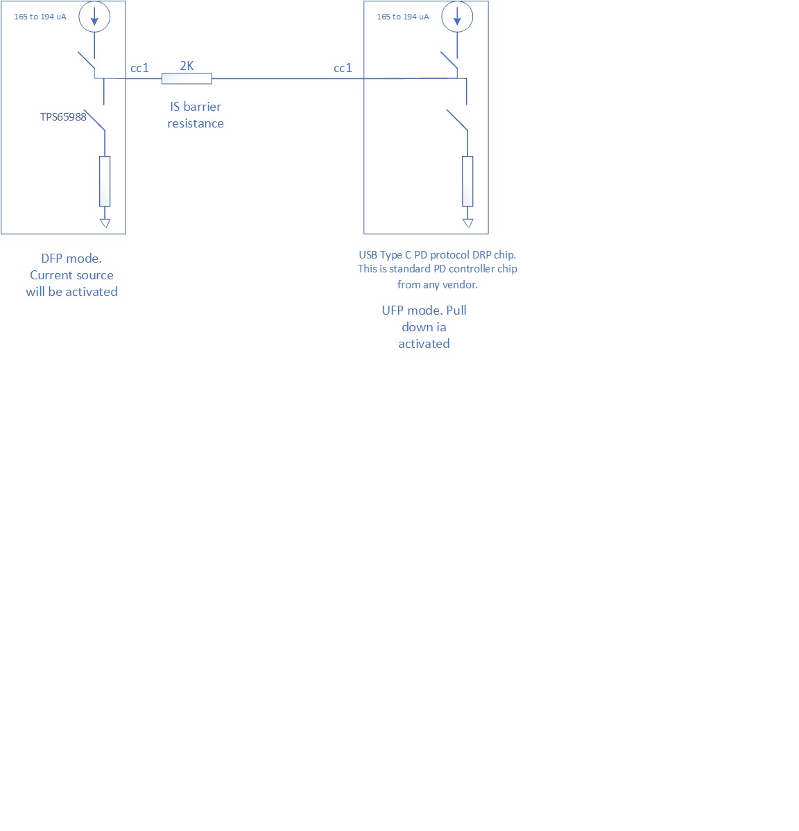

For our application, we have requirement of adding 2K ohm series resistance on CC1, CC2 lines of Type C connector. Attached is diagram.
We are going to use USB PD protocol with series resistor as shown in figure.  I checked levels in table 6.8 of datasheet. The voltage levels are meeting criteria. Do you see any risk in this implementation
