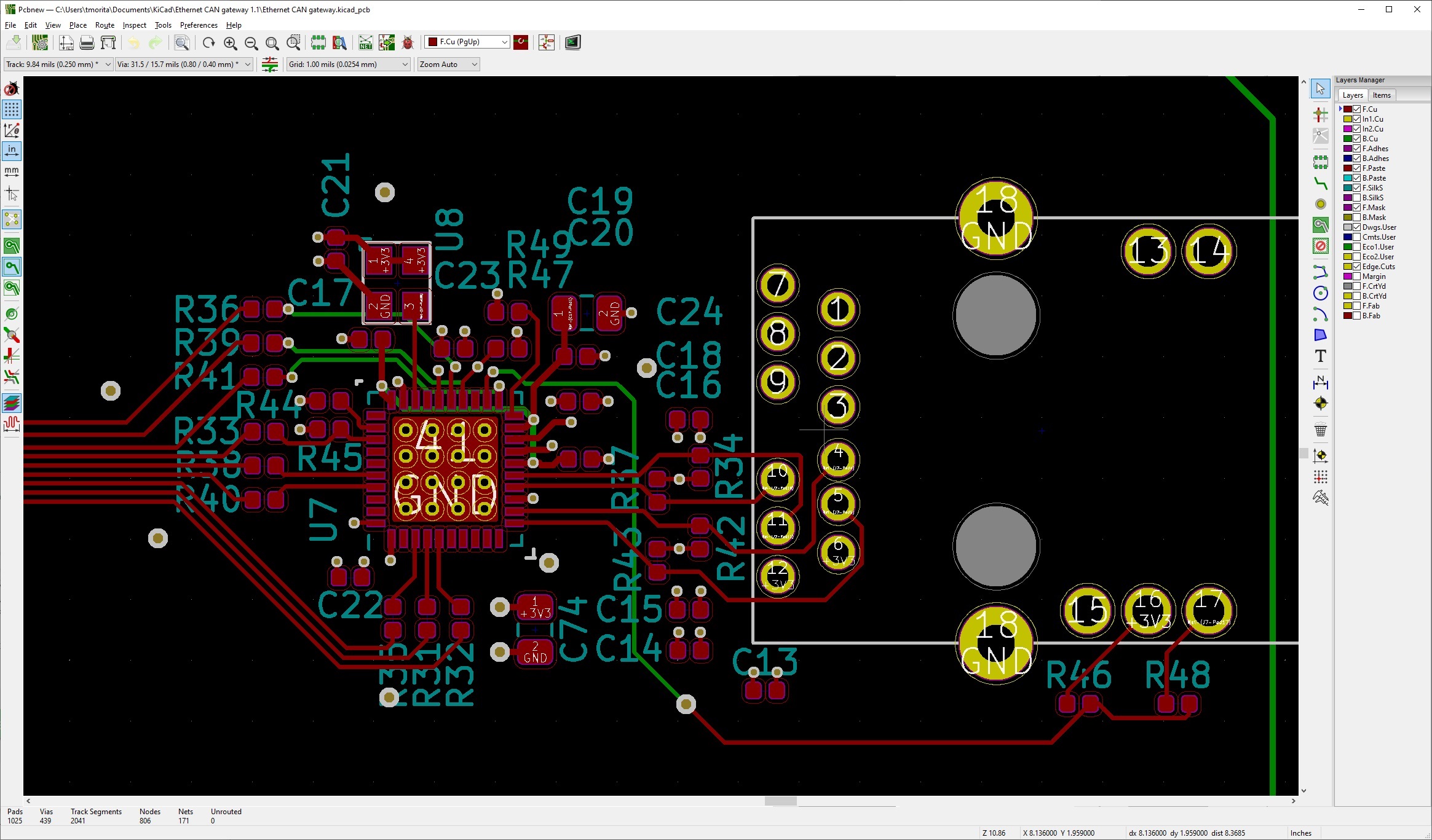

I just realized on the board where I have a non-working DP83848Q-Q1, I forgot to ground the DAP.
1. is the DAP required to be grounded for proper operation?
2. What are the symptoms of the DAP not being grounded?

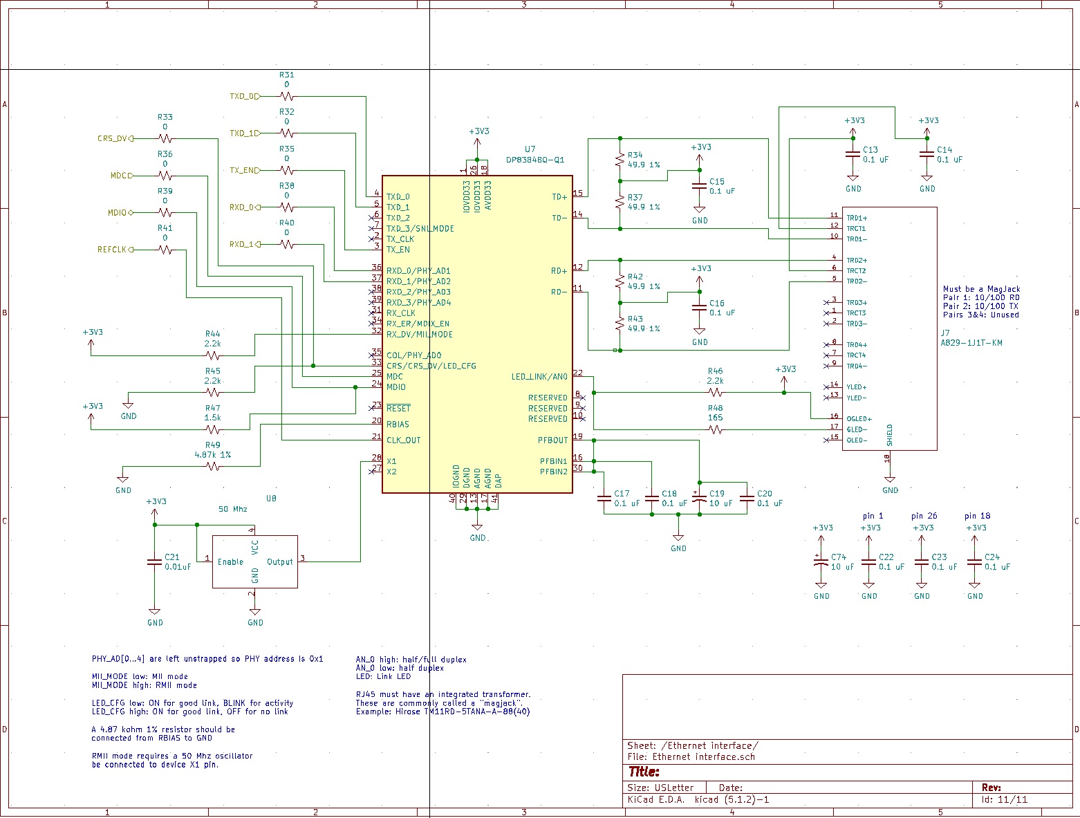

Please check the following, and if not resolved share the schematic with me:
Vibhu
1. MDIO has a pull-up resistor, yes.
2. Address strapping is left as default.
3. Oscillator is 50 Mhz +-50ppm.
4. This is the only Ethernet PHY on the board.

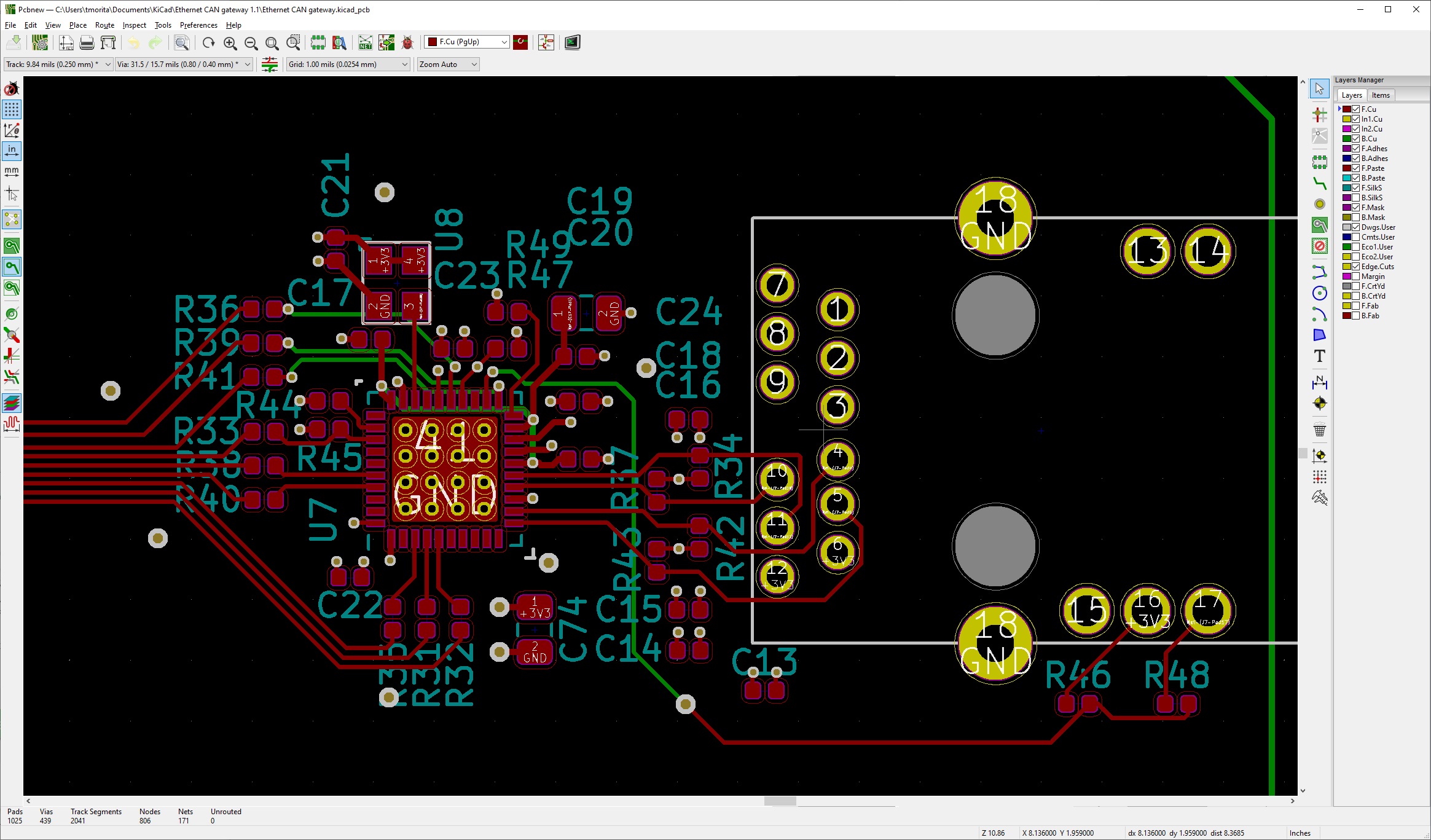

The MDC/MDIO issue seems to be fixed by the new board revision.
I forgot to windowpane the solder paste under the DP83848Q-Q1 so I suspect it was floating on the solder.
On the previous board I didn't see a consistent wicking of the solder onto the pins.
On the new board I see consistent wicking of the solder onto the pins.
I can now read register 0, and it returns value 0x3100.
This value seems to be correct, so the SMI interface looks good.
