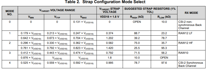

    • Check Mode Pin to make sure it's in RAW mode:
    • RAW12 LF: 12-bits DATA + 2 SYNC bits
    • Input PCLK range of 25MHz to 50MHz
    • RAW12 HF: 12-bits DATA + 2 SYNC bits
    • Input PCLK range of 37.5MHz to 100MHz
    • Line rate = FPD3_PCLK x 2/3 x 28
    • RAW10: 10-bits DATA + 2 SYNC bits
    • Input PCLK range of 50MHz to 100MHz
    • Line rate: FPD3_PCLK/2 * 28

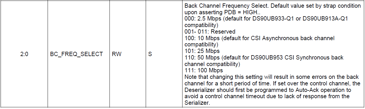

    • Check register 0x58 for back channel frequency:

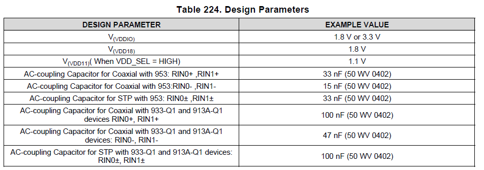

    • Check AC coupling caps:

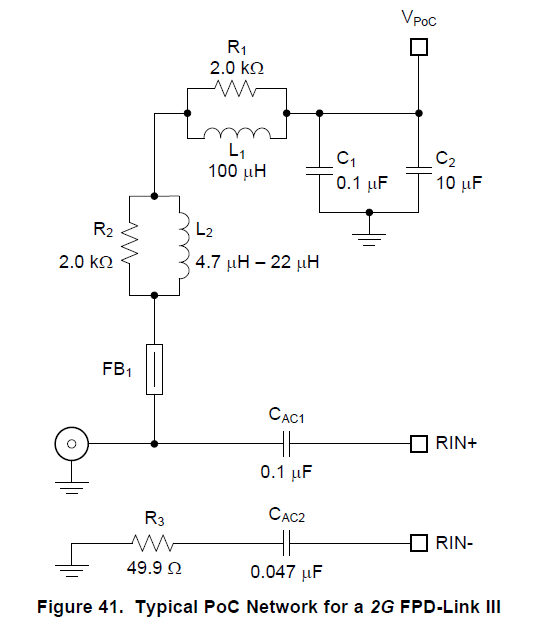

    • Check PoC Network:

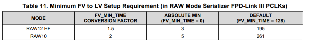

    • Verify FV and LV signal timing
    • FrameValid (FV) = VSYNC
    • LineValid (LV) = HSYNC
    • FV must be high for a minimum number of FPD clock period (FV_MIN_TIME) prior to LV high:
    • If this requirement not met, sometimes first line is discarded, and last line becomes garbage
