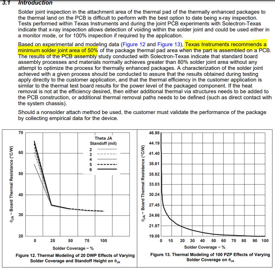

hi, Team.
As the apps note we have below which mentions that TI recommends to have soldering coverage 50% at least.
http://www.ti.com/lit/an/slma002h/slma002h.pdf
could you give us the RΘja in case of 30% ?
customer 's soldering coverage would be 30% and they want to know how much its thermal performance would change.
how much RΘja will be in case of 30% ?
