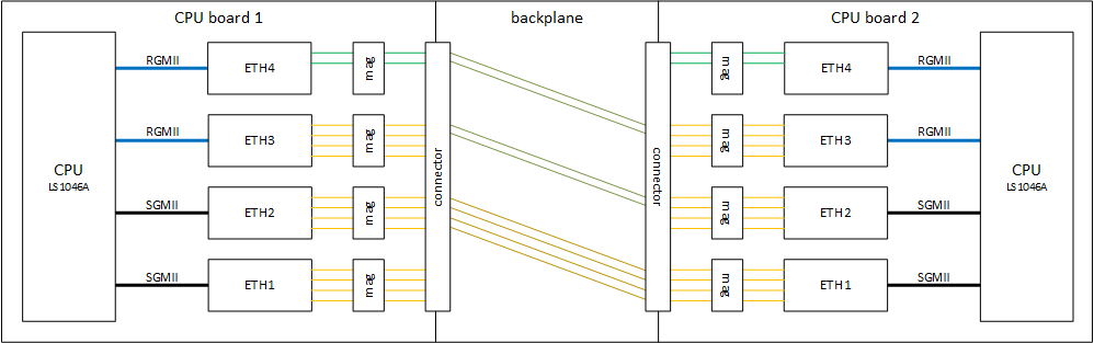

  • Hello Vibhu,
    it seems there was a misunderstanding regarding our setup, so I made an illustration for clarification:
    The ethernet PHYs should establish a link to another PHY without the CPU involved, and even if the CPU is in reset. For cases like board 1 ETH2 to board 2 ETH1 with 4 wire pairs this works fine. But when only two wire pairs are available no link is established.
    My expectation is that as soon as the system is powered up, while the CPU is still in reset
    - board 1 ETH4 and board 2 ETH3 establish a 100Mbit/s link
    - board 1 ETH3 and board 2 ETH2 establish a 100Mbit/s link
    - board 1 ETH2 and board 2 ETH1 establish a 1Gbit/s link
    Why is it that only the 1Gbit/s link is established?
    Ferdinand
  • Hello Ferdinand,
    To achieve 1G link, regardless of type of MII interface being used all 4 pairs of MDI must be used. With 2 pairs you can establish 100M/10M links.
    Your expectation aligns with my thoughts on this.
    However, auto-negotiation is defined to work on channels A & B of an Ethernet PHY. This is why you see that they link up at 1G, only to immediately have the link drop.
    Your options are to either disable the 1G advertisement on the CFG1 register, force speed to 100M or to enable speed optimization on CFG2 register (the latter is more of a debug feature). All three options will require register programming.
    Vibhu
