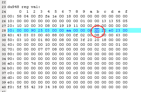

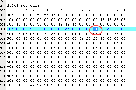

Hi TI team,
Could you please help us confirm what each value ds90ub948 0x3B means by EQ Status?
As below 0X3B value is 27,17,0f,2f

Hello Jimmy,
can you please tell me what is the background of the question, and what info are you expecting?

Jimmy,
17: is EQ level 9
27: is EQ level 11
0F: is EQ level 8
2F: is EQ level 12
All these are high EQ levels which you should not get with a short cable < 4 meter.
I believe you are not following the Power-up sequence on the Serializer side.
Hamzeh
