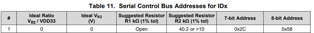

My customer chose the address 0x58, but they use R2=10k which doesn't meet the recommendation in the datasheet. What is the bad impacts?

it is okay to use 10K ohm here with 1% tolerance.
Hi Hamzeh,
If the resistor is smaller than 10k, what will happen?

Does this cause the I2C address to be incorrect? For example, I set 0x58, but due to smaller resistor, the I2C address is not 0x58.

I am not sure, but this is possible!
Please follow the d/s instructions to be in the safe side!
